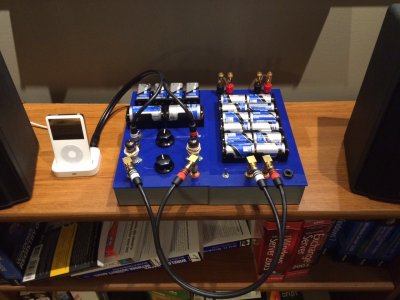

Installed the PJCCS upgrade last week, and I notice a definite improvement.  These old Klipsch KSB1.1's aren't the worst match in the world either, they sound pretty good.
The rubber bands were an attempt to reduce the microphonics, I don't think they're actually doing anything, but someone had tried it and recommended it.  The microphonics are only really a problem if the system is being moved or touched in any way, so not that worried about it.
I love this Bottlehead thing!  I need to put the badges on.  The boxes are the 2" deep Hammond enclosures.  The interconnects, right-angle adapters and banana plugs are all from Monoprice.  Batteries from BJ's Wholesale Club, and still my original set.  I don't know how many hours I have on them, but I haven't noticed any degradation in sound yet.

Cool system!  Wish I had some tubes to listen to at work  8)  One thing you could try for microphonics that would damp the tubes a lot is copper plumbing couplings.  If you wrap the tube with some aluminized tape (the kind used to fix dryer ducts) on the tube then slide the coupling over, it reduces microphonics a lot (wasn't sold on damping at first, but wow, what a difference).

Dave, I may have some plumbing couplings around, I will give that a shot.  Thank you.
