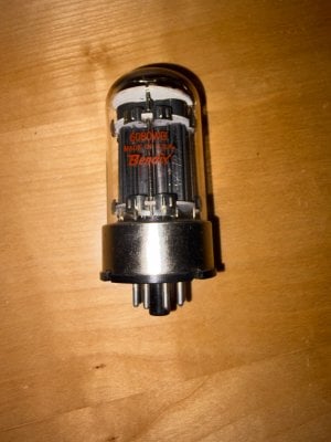

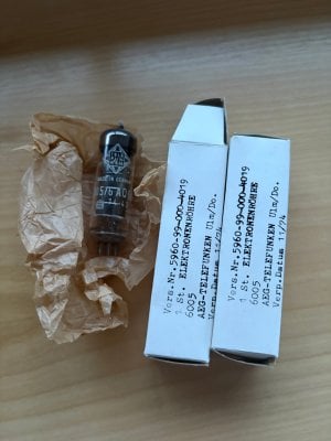

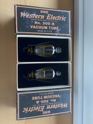

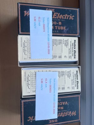

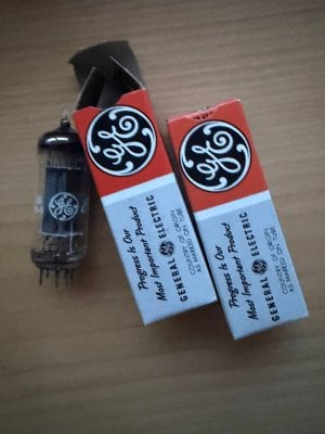

All matched and unused with excellent test readings. Can someone from Bottlehead confirm to me that the 6CM7 tubes which were included in my BeePre2 upgrade kit are matched? Would be a shame if they weren't. If someone has recommendations for sockets that match these tubes in terms of premium performance (I prefer gold and silver as conductors), dont hesitate :)

We try to match brands for visual consistency, but as Paul points out - matching doesn't make a difference to the sound so we don't invest the effort to match the tubes beyond that.
