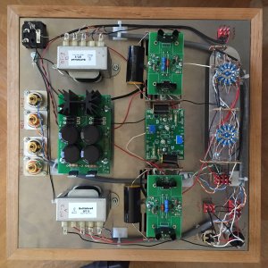

Here it is, a long time coming. I received my Mainline Amp kit in early March. I went full bore as soon as it arrived, spending three nights getting everything assembled. At first it worked, though not perfectly. The sound was...okay. After all the reviews, I was expecting a significant jump from the Crack I built last year. But I wasn't feeling the magic. To make matters worse, the amp developed a short a few days after the initial build, eventually losing sound altogether. Cr@p. I began my troubleshooting, but could not get the necessary voltages as per the manual. And then work took over and the Mainline remained on my kitchen table, with tools strewn everywhere, for about two months. Back to my trusty Crack I went, eating my meals at my desk or by the sink...
In a cleaning fit this past weekend, I finally decided to put my tools away. But that meant rededicating myself to fixing my Mainline. I took my time, and resoldered and tested anything that looked suspicious until I got the necessary voltages. At last, it was time to once again put this box through its paces.

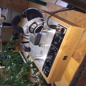

I'm a relatively newbie to DIY projects. Between the initial build, and subsequent troubleshooting and resoldering, I estimate I spent about 24 hours in total completing the amp. It was definitely more work than the Crack. I'm also not as manly as some others on this forum -- I have no woodworking skills to speak of. I just gave the wood a couple of coats of Danish Oil Finish. It was simple to do, and the result is great. Plus it keeps the amp looking close to stock, the way I suspect Doc likes it.
My apartment is finally clean, the music is flowing, and I'm back to eating at the kitchen table. All is good. Thanks for reading.
