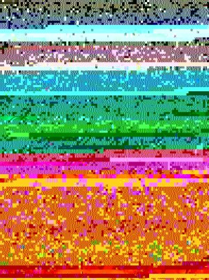

Hello,
Completed building my 1st Bottlehead kit (Stereomour) last July 2013.
I'm very happy with this build experience. The documentation/instruction is A+ in my book.
Have put in ~100 hrs. of listening.
Upgrades installed:
* Jantzen superior Z caps
* Goldpoint selector and volume controls
* Psvane 2A3-T
* Psvane 12AT7
* Wood knobs
Sources MCD 205 CD changer, Acoustic solid TT w Graham robin arm, Lyra Clavis DC Cartridge, K&K Audio phono stage.
Speakers: Lore by Tekton Design
Room: 15'L x16' W x 9' H
Music: Jazz, R&B, Rock, female vocals
This amp just gets you hooked..mildly put.
Thank you BOTTLEHEAD TEAM!
Joel
Nicely done, inside and out! Good choices on the upgrades too :) Are those Kimber speaker cables?

Thank you. Yes, speaker cables are Kimber cable 8-TC that I purchased used and connecterized by me.

Thank you.  I installed all the upgrades during the build. Took my sweet time building it...so I can taste the experience longer..

I got the wooden knobs from dknob.com (cocobolo wood).

Yes, I did some comparison listening - (Jacintha- "The girl from Bossa Nova" -180g/45rpm).
First thing I noticed is that the Psvane are quieter (hum is down to 0.6mv compared to Sovtek at 1.2mv).
The stock Sovtek 2A3 are good (especially w/vocals) but IMO the Psvane 2A3-T are just in a different league.
With the Psvane the music just comes alive with excellent PRAT (if you will). It conveys good vocal recordings as if the
performer is right in front of you on a microphone. The instruments are more pronounced (guitars are my favorites).
But I have to admitt that this is only the 2nd pair of 2A3s I have experienced.
On a side note-IMO- the Psvane 12AT7 has better sound dynamics than the stock & Mullard (from experience).
