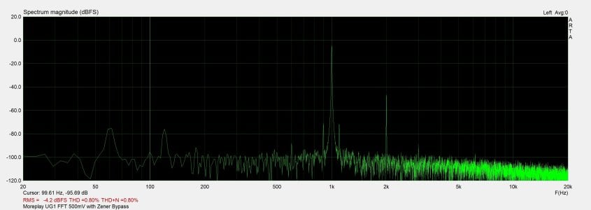

Here is the Moreplay with the upgrade module. Notice how the 2kHz spike is pretty much left alone, but everything above that is totally wiped out. This is a good visual representation of how C4S loads can retain that nice tubey 2nd harmonic distortion, but the harsh stuff you don't want is almost gone. You can still see the 3rd harmonic at 3kHz, just barely, and everything else is just buried in the noisefloor.
