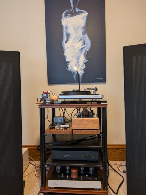

Im having issue with Foreplay III volume level is being very low - having to set volume to 7/8 th step to get decent sound.
Can Foreplay III be upgraded to get more gain if so any instructions available for upgrade?
I do not have the build manual for Foreplay III as I bought it used
Setup
- Rasberry PI 4 mooDePlayer Streamer with ProtoDac
or Clear Audio Concept turntable with Clear Audio basic phono
Rogue Audio Atlas Magnum power amplifier
Magnepan LRS speakers
