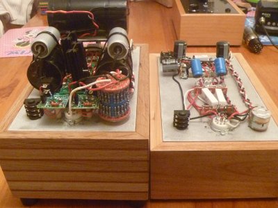

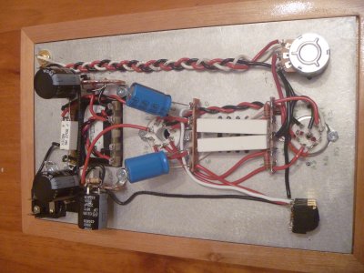

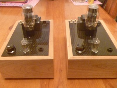

A ha, well I had so much fun building my Crack I couldn't resist building a couple more. With a few kits under the belt now I am starting to really enjoy the building process rather than being just plain terrified as I was to start. And am already thinking about what to build next!
The intention was to build a stock Crack to use as reference against my original and now hot rodded Crack and my newly built Sex amp. While I only really needed one combining postage with the Sex made sense.  Having assembled the bases and covered the top plates a couple of months ago progress stopped due to work commitments and then a much needed holiday for the family and I actually forgot about finishing them completely until talking about build projects on headfi recently jogged my memory!

Here is what you need to do, flip one of the chassis plates to make it a mirror image, then convert them both to monoblocks :)
Nooooo. don't go putting ideas like that in my head. While its been a bit of a distraction and fun building them it dawned on me last night I have to many amps the two Cracks have pushed the total to seven headphone amps in the house! Time for a big ruthless clear out. The Sex being the only guaranteed keeper!

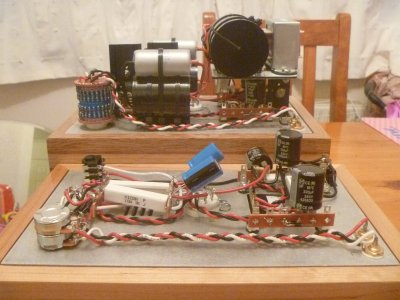

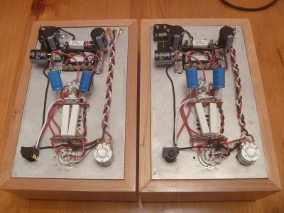

Grainger49 said:
That is nice tidy work on the stock build.  How about a belly picture of the two side by side?
Just for you can you..
Jamie,
I'm confused now.  Which one is hot rodded?  They look identical to me.  Except the one on the left looks a bit tidier.

Jamie,
Thanks, that is one jam packed Crack.  I'm particularly impressed with the table at the back holding the PS choke and final PS capacitor.
Grainger49 said:
Jamie,
Thanks it seemed like a good solution to fitting it all in, one thing that continues to surprised me is over the last year I have become really used to the weight of the hot-rodded Crack it was getting moved back and fourth up and down stairs to use either in the bed room or with my turntable downstairs on a pretty regular basis, now every time I pick up the stock Crack to flip the top plate it always feels unexpectedly  light.
