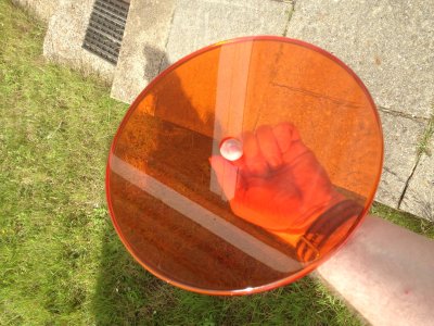

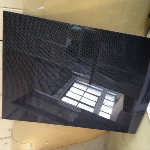

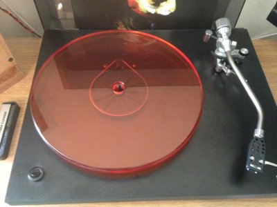

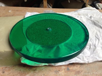

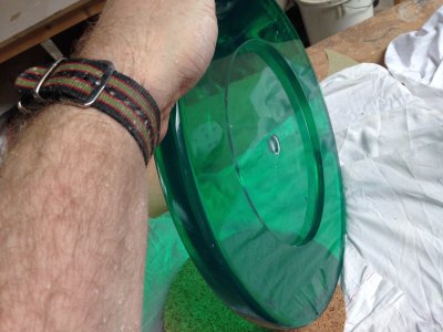

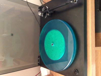

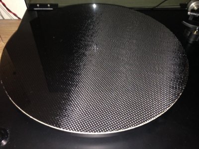

Hey guys I never really imagined I would be mucking about with diy audio stuff a few years ago BFBH (before Bottlehead) but now I’m finding the Mainline hd800 combo is proving very helpful in evaluating some diy turntable platter upgrades I have been having a bit of fun with.
I decided to knock up a few different platters after looking online for some upgrade options and choking a bit at how much some sellers were asking for Acrylic platters and carbon fibre record mats.
Thanks guys for such great sounding amp and tool.
Orange 20mm thick flat
Green 27mm thick "flywheel type (like on Rega 6)
Hybrid Carbon cork carbon record mat 2.5mm thick

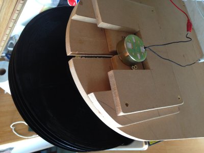

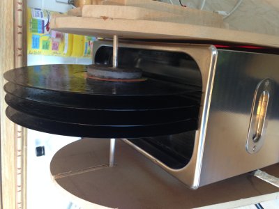

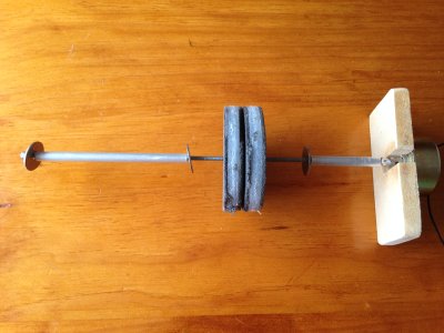

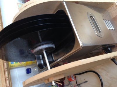

So a diy record cleaning machine has been on the to do list for some time and after ages looking I bit the bullet and picked up a ultrasonic cleaning tank off of ebay. After bodging some bits of mdf together into a frame this afternoon I now have a working ultrasonic record cleaner  ;D
Ok I know it needs a bit of finessing to make it a bit more safer and user friendly but I ran out of time as I was keen to get to the local auto parts store  to pick up some deionized water before they closed and test it out.
I need to refine a few aspects of the construction like fit some proper cabling and a box for the motor add some small rubber o ring grommets on the spindles etc all to make it safer and perhaps some pieces of ptfe sheet for bearings and bit after of paint.
But importantly it works and after putting a few LPs through that I knew were bad with lots of pops and crackles etc its proving a very effective way to clean deep into the groove. The difference it made is genuinely outstanding from terrible to as clean as digital on many of the tracks what a result and I can honestly say hand on heart my records have never sounded so good.
I'm kicking myself a bit for not doing it sooner.

Hi Richard, I used this tank.
http://www.ebay.co.uk/itm/201388312013?_trksid=p2060353.m2749.l2649&ssPageName=STRK%3AMEBIDX%3AIT

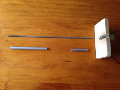

And this motor (you can find motors for a less) but this one had a M4 threaded female shaft which made it real easy to attach the spindle to.  You could always just turn the records by hand instead of using a motor.
http://www.ebay.co.uk/itm/151604587292?_trksid=p2060353.m1438.l2649&ssPageName=STRK%3AMEBIDX%3AIT

The recipe I followed was temp 40 Degrees Celsius and 2 tsps of Isopropyl Alcohol per gallon of distilled water

How did you source the spindle?  Sorry for all the questions but I cannot find anyone that supplies spindles or shafts that might work.
Thanks again,
Richard
rockpassion said:
Jamie,
Thanks again,
Richard
Hi Richard
I used a short length of 4mm threaded stud bar then used a piece of small alloy tube to go over it.
Both should be easy to source at a local hardware store or on ebay they are only a couple of dollars. The 4mm stud bar winds  straight into the motors 4mm threaded drive spindle.
You will get the idea from the pics

denti alligator said:
And what did you use for spacers?
I cut some discs out of a plastic bread chopping board and covered them with some foam sheet which had a self adhesive backing
