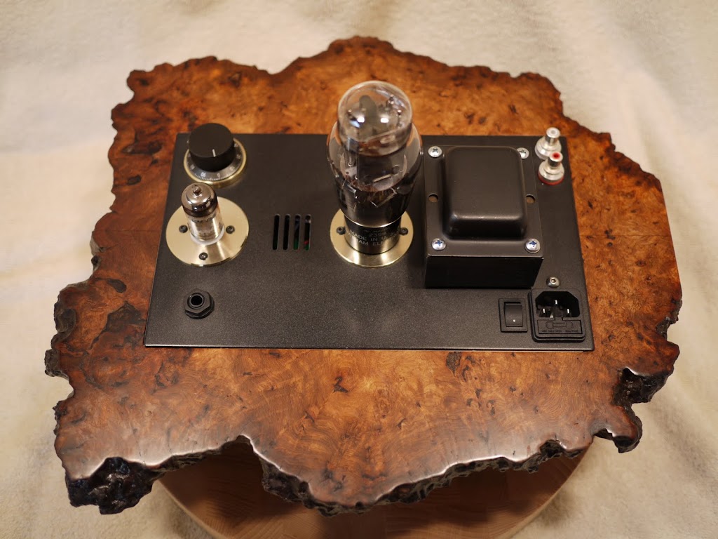

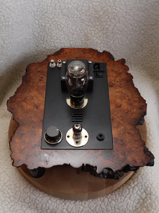

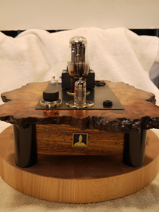

Finally finished my Crack last night.  The top is Honduras Rosewood burl, the legs are Gabon Ebony, and the inserts are Bocote.  I had a lot of problems with the paint flaking off the top plate, it was sand blasted, acid etched, uses epoxy primer, metal flake black paint, and top coat satin lacquer.  It is time to get a powder coat gun system, less than an hour and the painting process is finished and ready to be handled.  It took a week to finish the Cracks top plate, never again.  The large caps are Aerovox 52uf/250V left over from an original Foreplay build, there are four installed.  Pictures at the link listed below.  Thank you for looking.

Lee, beautiful wood!  That must have been a frustrating top plate.  My Seduction, my first Bottlehead build, got all kinds of dust in it and had to be sanded and repainted.

That build looks great!
Your photos are just what I needed to finally get off my ass and order this kit....
A few questions:
- Where did you get those sweet tube sockets and bases?
- Where did you get the volume knob and trim ring?
- Those look like the latest WBT RCA jacks, correct?
Mike
Thank you all for the nice compliments.
Mike the teflon sockets and cu/ag rca's are made by CMC (Yamamoto clones), make sure you get the tube socket PCB adapter, it makes soldering alot easier, besides they look cool.  I get them from ebay vendors.
The volume knob is from VT4C studio (vt4c.com), interesting site.
The brass trim rings I make myself, will add ventilation holes as on the Quickie when I can get the time, actually it is when I can remember to do the machining, have lots of time.
Lee Hankins
Hello! Magnificent work. I am looking to upgrade my V. Pot and had a question...Is this the PEC Pot part (say that 3 times) you used ? Digi-key # KKA1041S28-ND (manuf# KKA1041S28). Thanks!!
